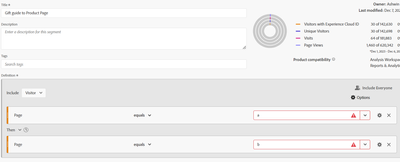

Is it like this
Hey @AshwinC5I
Equals A and B were just sample values. You can put in the actual page name in there.
Also, I would suggest use 'Page' dimension for anything related to page names if you have proper naming in it. You are currently using an eVar in the above example.

@AshwinC5I Is it okay for you to share the screenshot of the segment once please. This one should be a straightforward one usually.
yes sure,
As I can see, you are getting 25 such visits as per the above screenshot @AshwinC5I
Am I missing something in the above screenshot ?
I tried it at my end as well and it did give me expected result.

@AshwinC5I You seem to have changed the segment definition to Visitor instead of Visit in the above screenshot ? I am also a bit confused with the segment definition saying a and b and the flow report saying product page.
