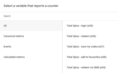

However, after the connection was established, I was not able to see any custom metrics I've created that could be accessed in the Adobe Analytics report suite project / via ETL tools like Supermetrics. I can only see general metrics as below:

In SA360, if you go to "New Conversion Action" -
From there:
I can see most of the custom events the Adobe Implementation team added since we onboarded Adobe Analytics. For example, form submits, video starts, video completion, etc.
However, we can't see any custom metrics the team created, such as form completion of a certain form, video start of a certain video, etc.

I replicated what you are trying to do and I can see custom events populated. I can also see Calculated Metrics and I think your use case can be solved through a calculated metric. For example, you can create a calculated metric with form submits with segment of certain form name applied. But your issue is that you can't see custom metrics? I went through Conversions Tab to create a conversion action per below screenshot.
