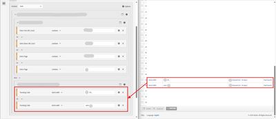

I am trying to create a number of Marketing Channel segments that follow the classifications criteria, but the metrics (Purchases, Visits, or even Revenue) do not line up. I am seeing a handful of tracking codes still populate incorrectly, specifically Paid Search.

I am creating segments that replicate the classifications that are listed below. Ex Paid Search.
The classifications are built using v0, which are using the tracking code, and so I am building a segment using the tracking code by using the same logic.

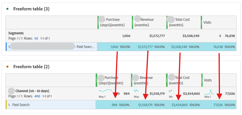

As you can see the #s are not lining up, and unsure why they aren't. Is it because the attribution in v0 is 10 days, which could be throwing it off?
Date range below is for 10 days as an example.

While tracking code and marketing channel are closely related, they have different scopes and I recommend not using them together. Instead, try using channel detail.
Tracking code - only set when a campaign code is set, typically persists for 30 days.
Marketing channel - there's a channel of some sort set on every visit
Example of where you'd see differences
1st visit - Monday - via email CID (channel = email, channel detail = em_test1234, tracking code = em_test1234)
2nd visit - Tuesday via organic search (channel = organic search, channel detail = google, tracking code will still = em_test1234 since the organic search visit didn't have a tracking code to overwrite the existing value)
That too... the 30 day vs 7 day attribution differences, plus the Marketing Rules take more things into account, like coming from a search engine, or the referrer, or if the hit is the first one in a session, etc.
Marketing Channel and Marketing Channel Detail unfortunately do not work well with trying to differentiate channels due to this organization, and how it's currently setup.
Thanks, this helps...
I suspect that there is probably some cross attribution happening with your Marketing Channels, and because your segment is Visit scoped, it's looking for any hit of that Channel in the Visit, not necessarily the last hit....
