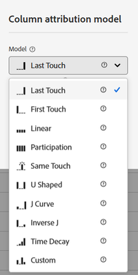

You can apply a custom attribution in Workspace.
Linear or Participation is going to likely be what you are looking for:
If your Marketing Channels are set to 30 Days, you should see no difference on the total, but all the rows of Marketing Channels will likely increase to show the participation towards the order with the range... you don't even have to match the same "30 Day" model, your can adjust this to your needs.
