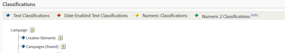

Does this seem like the culprit?  (i.e. because according to the conversion classifications- it looks like creative elements is being treated like the parent classification hence why the none bucket is populating in both creative elements and campaign).  So it would basically proactively fix the problem if we were to switch the two to where creative was actually at a lower hierarchy compared to campaigns and if we were to get a unclassified tracking code then it would only populate in the Campaigns Parent "none" bucket?  Does this make sense or do you think this would solve the problem and remove it from the none bucket in creative elements- moving forward at least as time goes on after it is adjusted?  See this screenshot of the hierarchy I found earlier today:
Actually it looks like it should be a sub-set or a child seated "under" campaigns parent for it to remove the none bucket from creative elements- from doing some online reading in the documentation here and here:
