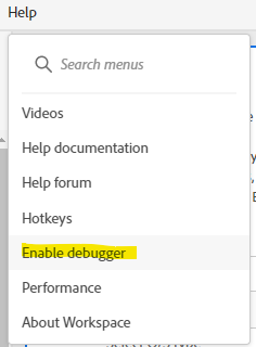

If you build this in Workspace, you can get the APIs used to build the Workspace by turning on the debugger under help.

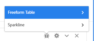

This will add a new icon to your visualization:
Clicking on it will allow you to choose the table data or sparkline, then it will show up timestamps of all the calls that were made:
Clicking on each timestamp will show you the API call that was used to build the table... note that these all have extra "table" fields, which you wouldn't need, but you can use this to help form your own API calls.
