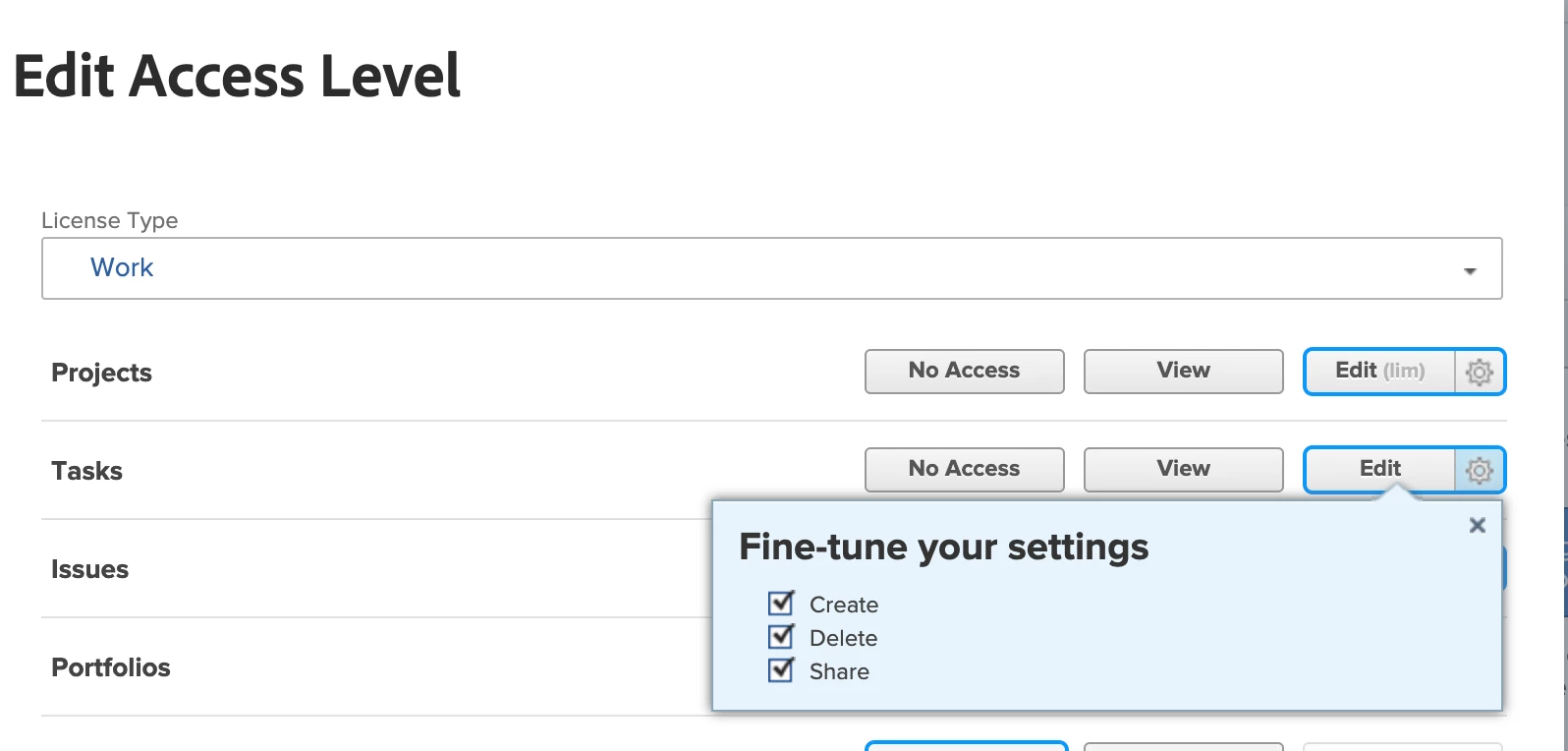

I would double check their access level to confirm that Edit (limited) for Projects is selected and Edit is selected for Tasks. In the gear icon next to Edit for Tasks, be sure that Create is selected - see screenshot.

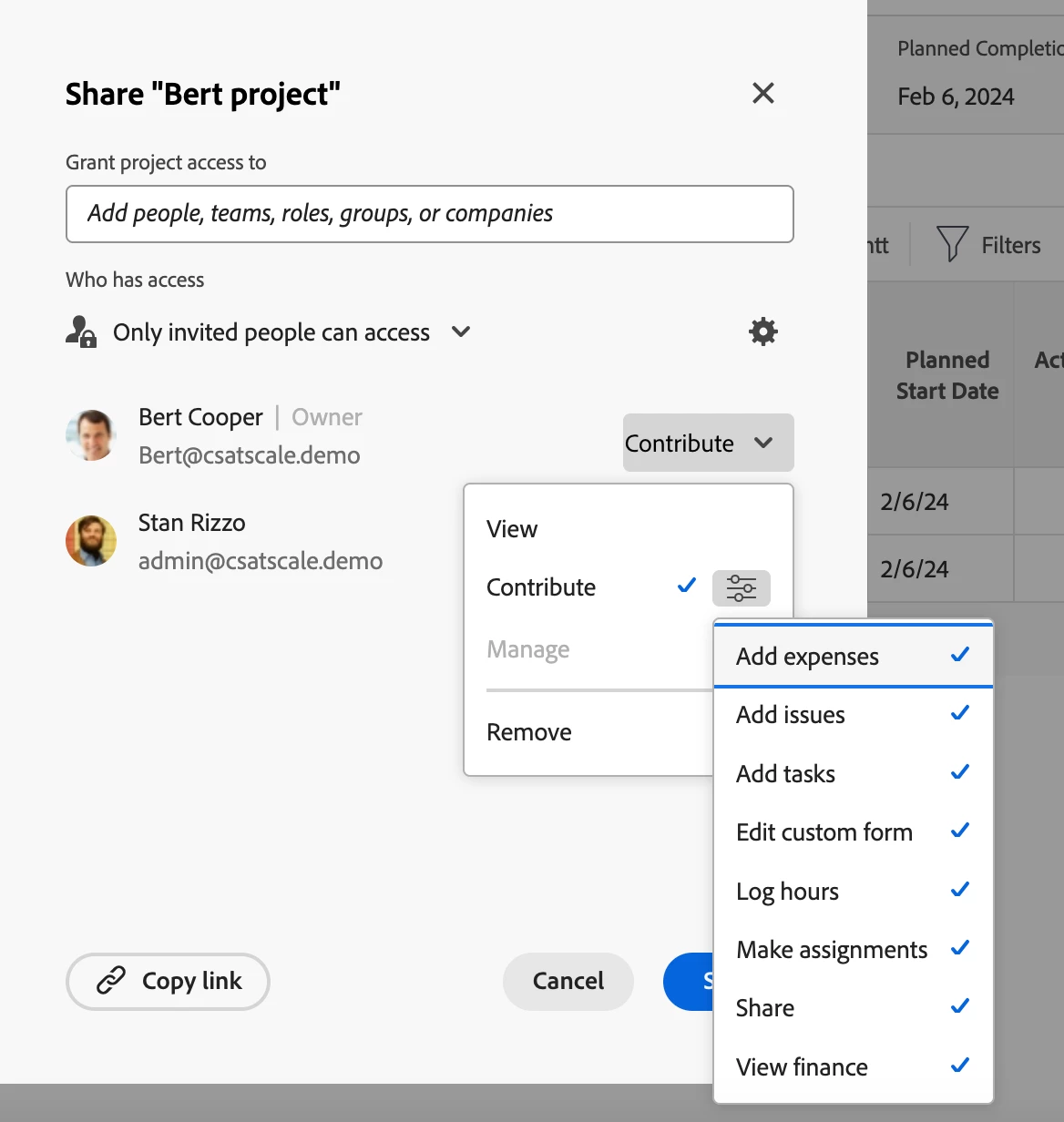

 If both of those are selected, check the Sharing permissions on the project itself. The user must have Contribute permissions with the option to Add tasks selected - see screenshot.

Thank you, @nicholevargas. It was the second area that you advised me to check. I'm not sure why this difference lies. I still think it must be something on the user level. I created both projects from scratch but one user defaulted to Contribute on her project, while the other user defaulted to View on her project. There was nothing special about the project setup, I started each project from scratch as a new project, no template involved. Do you know what could be causing the user defaults to be different for the projects?

I did finally get to the root of the problem. Linda was originally set up as a Requestor and after I had created her project and made her the project owner, I discovered she could not add tasks, I updated her license to Worker just as Sasha was set up (knowing that Sasha could manage a project she was the owner on with her user settings -- add tasks, etc.). What I did not understand was that the update to Linda would not affect anything retrospectively on Linda's project. So I found that I was able to go to Linda's project and update the project to Contribute as you shared above. That worked. It seems that the difference in user setup issue was just an issue of the sequential order of steps to update the license within the process of setting up the project.
