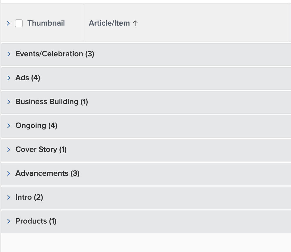

Is there a way to sort your groupings alphabetically? Does it have to do with the sorting of the columns?

You can do it via adding the column and sorting by it, but I'd like to know if there is a way to do it without adding the column of data just to sort (since the grouping shows the data).
