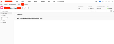

Below is the request made, as you can see there are three sections:

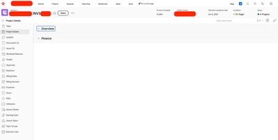

And here is the resulting project that was converted from the request, missing the Resi - Marketing Event Expense custom form:

The latter -- the person converting the issue should have attached the custom forms somehow, WHILE converting the issue.
https://experienceleague.adobe.com/en/docs/workfront/using/manage-work/issues/convert-issues/convert...
Ideally the way others have set up their instance, the user would use a template that has forms pre-attached. Most users don't think about information transferring over from the issue (and shouldn't have to).
If the request form is filled out and the project is blank, start over -- delete the project, and reconvert the issue, this time making sure that the info from the request is transferred to the project before you hit that create button.
Okay. Adding to my lack of experience, here. My request queue has the correct custom form. When the user converts the request to a project, is the custom form something that they have to add manually, before finalizing the conversion? Or is it something that I can have automatically be added to a project when they convert the request to a project?
Edit: I am slow on the uptake. I was able to find that the template they created didn't have the custom form assigned to it, so that was what was causing all this goofiness. Thank you a ton for the help, regardless.
