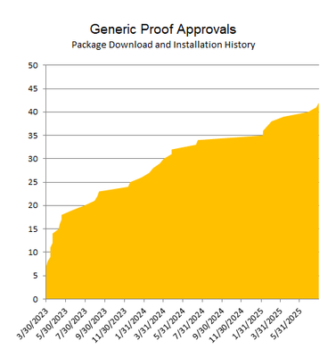

Hi Folks,
I'm pleased to share the following correspondence and stats from yesterday to thank @Kurt_Jones, those who've downloaded and installed the Generic Proof Report Package, and encourage others who might benefit to consider doing so, too.
In a related story, we're interested in Blue-Skying the ideal Proof Monitoring Report (e.g. Gantt charts with red/yellow/green bars showing how long proofs have been held up with certain approvers, possibly with their picture next to each, filterable, sortable, etc.), so if you have any ideas for feature requests, you're welcome to email them to me at doug.denhoed@atappstore.com
Doug
Hi Kurt,
I just had a call with a SysAdmin who’d read about your Generic Proof Approvals report and wanted to download the package you and I created in our www.atappstore.com catalog. It installed cleanly and rendered beautifully! Your package is one of the most downloaded free offerings, so I thought I’d drop this short story to thank you again for sharing it with me and the community.
