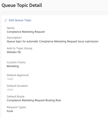

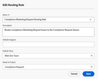

  • Webdev Pjt Template - This is where I am adding Queue Topics, Routing Rules to route Issues that use the same Custom Form available in the Compliance Request form in the Request queue.
Issues route to the Compliance Request Project just fine. However, because it is not a formal 'request' from the request tab, and instead is an issue generated in the Webdev Pjt, the issue is routed automatically and silently, with no way for the Issue submitter to know where the Issue has gone.
