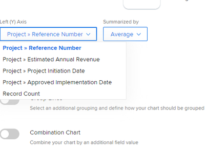

I created the calculated field in the form that gives TAT per project.  I created a text mode column in the report that shows the average TAT.  The field I need to group by is the text mode column field and I cannot do that so I tried the other way and grouped by the TAT at the project level and the result is not what I need.  I grouped by Project size, Turn around time and Approved Implementation date (Year).  When I go to the chart, I do not have Turn Around Time as an option to select.
Grouping is as follows
things to check:
1) In your form, is your calculated field formatted as a number?
2) in your report, you needed to put it in the column view. When you bring it into a column view, are you selecting Average under the dropdown that says "Summarize this column by" in the columns?
I just went back and looked at my calculation and it is saved as text.  Is there a way to change the calculation to number now that t has been created?
I do have the column view in my report but I don't have the option to select summarize by average and I assume that is because the calculated field is text and not number.
no, just copy the calculation and make a new calculated field and format it as number

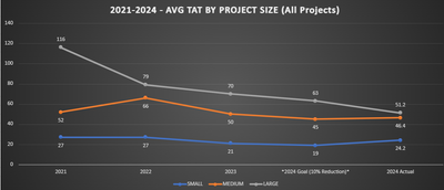

WOOOHOOOO!!!!  It worked.  THANK YOU!!!!  One last question (hopefully) now that I have the average turn around time by project size in my report chart.  Is there a way and the year in there so it would show ave TAT by project size for each year 2021-2024?  So it looks something like this?
I would probably say to look into combination charts? Or work with a remote consultant if you can't get it.
