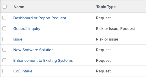

Hi John,
If you're using Queue Topics, you can pull them directly into an Issue report by pulling the Queue Topic Name (queueTopic:name) into a field. You can then group by the field.
Alternatively, if you could try the Request Type (Topic Type shown above) field if you have associated them distinctly with the types of request.

Thanks for the reply Teale. We don't currently use Queue Topics. The issues that I want to report on are project issues that do not go into a queue. I created a test project and created some test queue topics within the project. Moving forward I would think I would put them into the project template. I couldn't find where I could assign a queue topic when creating a project based issue. Id appreciate it if someone could provide a little more information to help me out.

Thank you so much Teale. I am using Queue groups and topics to categorize project based issues and have created a report that groups by topics so we can look at trends that may lead to a change in process or more training for our users.
