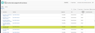

Is it possible to pull issue name into a task report when the issue is not converted but just moved to the task?
I have a process where we are trying to see if an issue / request has been submitted that gets moved to tasks. I need the report to stay as a task report due to certain necessary filter criteria that I can't apply to an issue report.
I need to reference if a task has an issue sitting on it - we don't convert the issues, we are just moving them.
Is this possible to do in text mode?
Here are some screenshots. Basically, I want the converted issue name, but it's not converted just moved.
