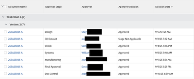

We use a proof approval report to create an audit log of proof approvals over the prior quarter.  We have multiple people that *can* approve each stage, but this report only captures the person that made the decision for each stage. Is that similar to what you're looking for, or do you need info about upcoming approvals?
this screenshot in the thread shows multiple approvers.

further down in the conversation, Kurt also shares text mode, talks about what kind of report this is, and so on. It looks like for some, the text mode works, but probably less error-prone, if you can just install the pkg
