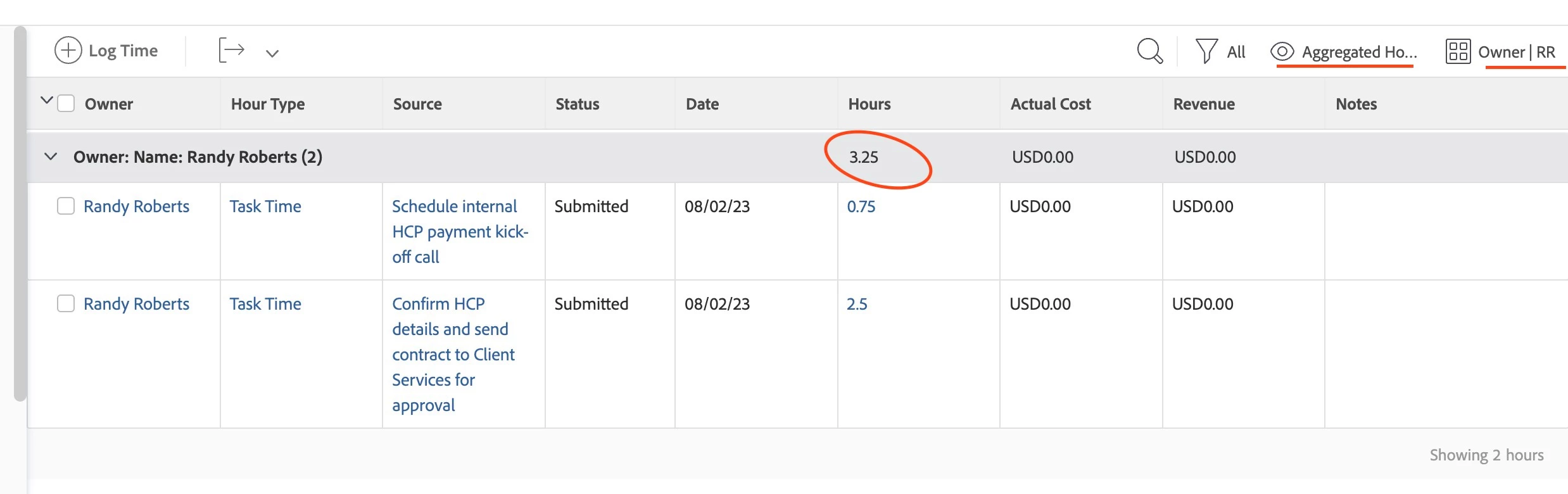

How about create a grouping by Owner, and a view that aggregates the Hour column? This way you can get your hours grouped by owner and a total all in one view.
Like this:

February 8, 2023
Yes, it's certainly confusing. I always set the Grouping on my hours page to Project, that will group all hours for that project together (not that it would be pulling in hours for any other project when you're in a single project 🙄). But this does total the Hours column at the top of that column.

February 8, 2023
Like this:

February 8, 2023
We do this but also clicking the Summary button allows us to view the numerical values instead of log entries if we don't have a particular report grouped in that way
