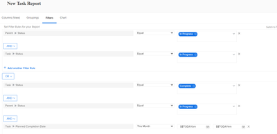

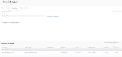

I would definitely create a Task type report (with maybe below similar filters and groupings).
Hope this helps! You can modify the filters further more accurately to pull the desired results.

Try this:
Create a task report and
  • add columns for parent task
  • group it by project
  • filter to
    • project status=CUR
    • task status = (fill in what you need)
  • add a prompt for entryDate and plannedCompletionDate
In a report you have to specify the grouping manually
You could also try to create a filter and view for the Task view on the project. E.g. filtering by status keeps the parent-child task display intact.
Level 7
