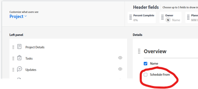

@ChloeWY  -- hey I was able to run some tests in my system today and finally discovered what the deal was. I'm enclosing a screenshot of the layout template my users are all on. This is the setting you would need to toggle OFF in order for the date to be today's date -- however, I must caution you that I don't know what else toggling that setting off would do, so please treat with caution.
Specifically it's the schedule mode (labeled as "Schedule From" on the layout template), and if you have different project templates with different schedule modes configured, you would just want to make sure those are coming through accurately.

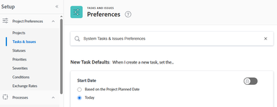

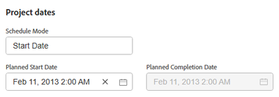

Hi @ChloeWY,
In addition to the Business Rules suggestion @skyehansen mentioned, from related Start Date documentation here and here and here I wondered if setting the Setup > Project Preferences > Tasks & Issues > New Task Defaults > Start Date = Today would "kick in" when an Issue was converted to a Project using a Template (i.e. "starting" the Template from "Today")...
...but as per this crusty old Issue from 2013, have now Busted That Myth, and confirmed that Managers need to override the Issue's date, as you'd observed (and feared):
Doug

@skyehansen I don't know how you found this setting or why it's in layout templates, but THANK YOU!  After a quick test, it looks like this is going to work!
I'm going to try it out and keep an eye on the next couple new projects.  I'll update here if I run into any issues.  Thank you!
yeah! Glad that worked. The key was seeing that my users were experiencing something different from yours, and that it wasn’t affecting my own account. Layout template settings have caused similar issues before so after being able to replicate the experience by changing my assigned layout template, it was just the matter of toggling the checkboxes until I switched the timing over to what you needed.
