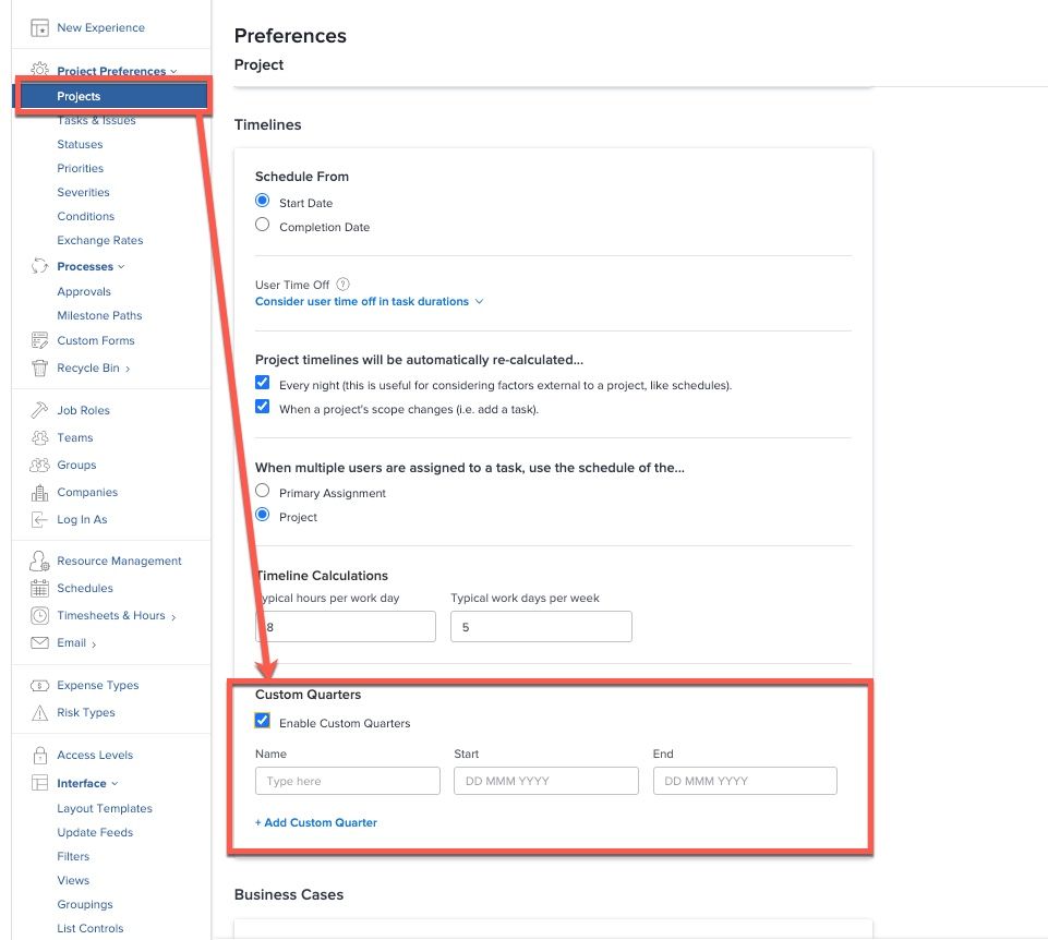

June 23, 2020
Hey Kevin,
Not sure if you are an admin or if this will even help, but you can customize your quarters in the setup --> project preferences --> Project
