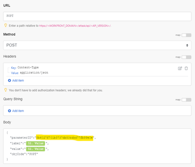

yes, this is fairly simple API call to make:
where parameterID is the ID of the field where you want to add new "option". Label and value are hopefully self-explanatory since they match 1:1 to what is visible in custom form editor.
Hope this helps

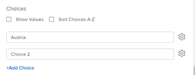

This is what I have so far but the options get added to the drop down field at custom form level, I only want it to appear for that one Project:
Any help appreciated!
If I'm reading this correctly you want certain custom field values visible only specific project.
I think you need dedicated custom form to achieve this. If custom form is added to multiple objects, updating custom field on that form will update it everywhere across the board.
And there is no way to hide some of the values only for some of the objects.
