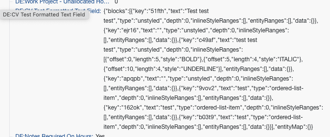

It appears to be a JSON encoding.  You could likely do some testing and play with things to figure out how you'd want to do it.  Appending would likely be as simple as just adding to the blocks array and republishing.
(I haven't tested this, just speculating based on the structure that I'm seeing here.)
