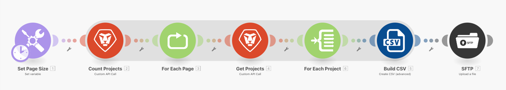

Pulling data from Workfront is going to be best done via a report or a search operation.  Then aggregate that data into a CSV.  Then upload to your downstream system.
Here's an example using SFTP as a destination.  You'd need to modify, of course, for your needs.
(Standard disclaimer: not tested, use at your own risk, you get what you paid for, etc.)  🙂
Good luck!
