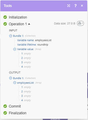

I tried this flow, but so far I was not able to make it work and not sure what I'm missing:
For example, I send file with 4 entries, 2 of them duplicates.
  • Array Aggregator module gets all 4 bundles from Parse CSV as collections and in Output is 1 Bundle as Array with 4 Collections
  • But next Set Variable module, where I map array from Array Aggregator is emptyViktoriia_0-1700677360530.png
  • Then next Set Variable module that is supposed to deduplicate array is throwing an error
What might be a problem?
