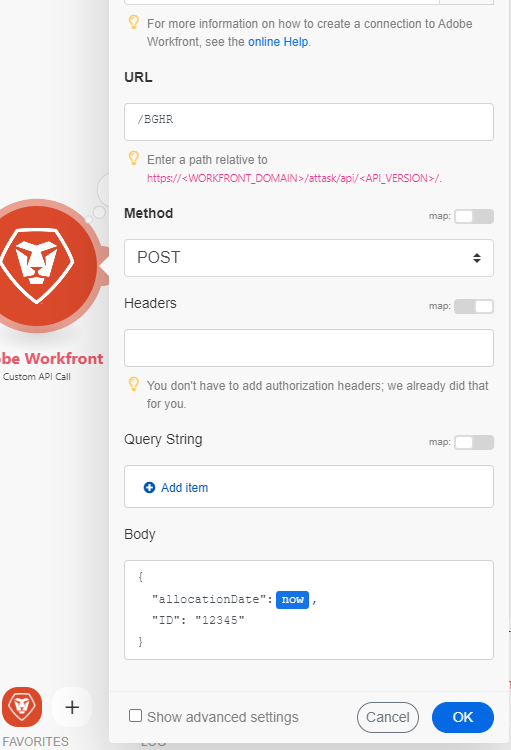

I'm trying to create a POST request for the "BudgetedHour (BGHR)" request
I'm having trouble figuring out how to properly format the body request or if I'm missing any additional steps. In my screenshot below I'm just using dummy data to get the request working successfully. The error its giving currently is "The operation failed with an error. [422] allocationDate cannot be null".fusion2.pngfusion.png

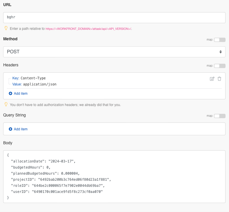

The issue is around encoding.  The Body is just a text string.  It doesn't auto-encode JSON.  If you want JSON, you need to use something like a "Create JSON" or "Transform to JSON" module ahead of time.  Otherwise, try something like this in the body:
  "allocationDate": "{{formatDate({{now}};YYYY-MM-DDTHH:mm:ssZ;UTC)}}",
  "ID": "12345"

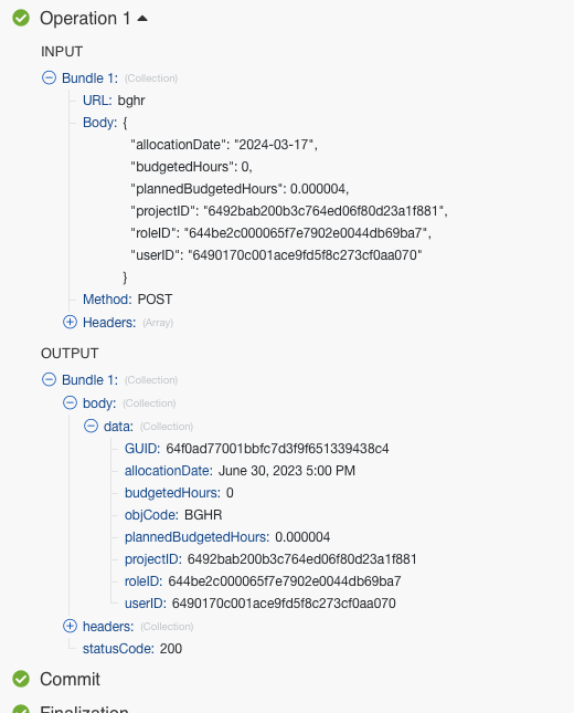

Not entirely sure, TBH.  I suggest you do a bghr/search call, get one of the response bodies, and use that as a template for pushing.  That's what I did, and it worked (as per my screenshots above).
