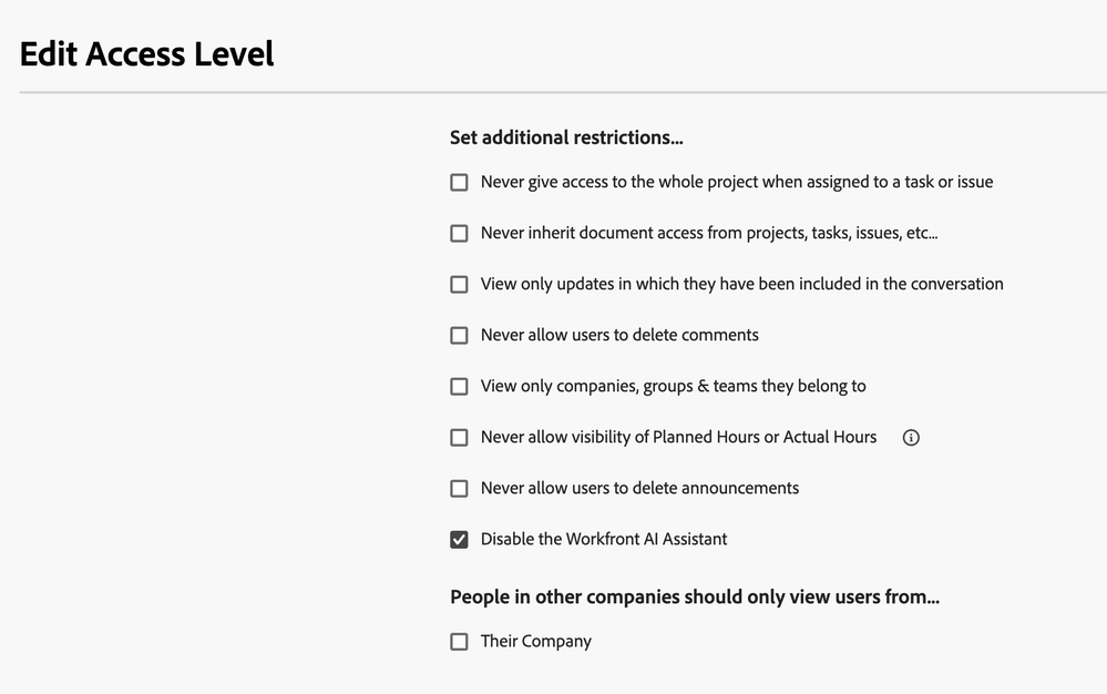

Since you have so many clients, if it were me, I'd probably test the changes in the Sandbox first.  Pick a user from one of the clients, lock down their access using the Access Levels (from the screenshot below), and start removing permissions from objects, and then login as them to see what they see.  Then create a test Company, and see if that's a bit easier. That's a lot of clients/users, so I'm hoping one way is way easier to build and maintain than the other!

When I tested separate company use for a group of external requestors, having the external requestors in a separate company from the main Workfront company, didn't allow the requestor to update on the request to anyone in the main Workfront company. The external requestor could only @mention to those users in their external company. Is there a way to allow users from separate companies to update on a shared object?
So, they can update the request, but they can't tag other users, right?  That might be a setting in the Access Level? You might try checking to see if some of these are locked down, and test if unchecking them gets you where you need.
If there's not an issue that users from different Companies can see other users, you don't necessarily have to hide the users.  But I understand in cases where competitors might exist in the same instance.   In that case, I'd probably create a cross-functional team that includes all of the folks that would need to communicate with each other, and tag them in updates.
No matter which combination that I test, users from different companies can't tag each other in a shared object update. I tried adding different company users to the same group and removed the company access restrictions and that didn't help.
Are groups and teams supposed to override the company permissions? Are users in different companies supposed to be able to update each other on a shared object if the settings are correct?  I'm not sure what I'm missing here.
