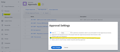

Ability to Edit Custom Form while Task is Pending Approval (Global Setting) - Original Post Link
This setting would have to be turned on globally (across the entire system) but there is a button to allow custom form editing while a task is pending approval. This helps if there is a QA checklist on a task that needs to be filled out while it is being reviewed. (Setup > Approvals > Wheel Icon at the Top > "Allow Editing the Custom Form...")
