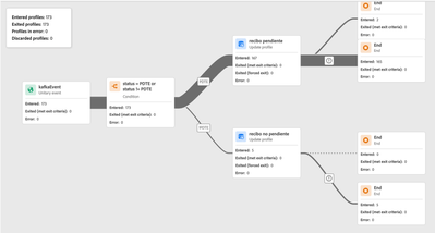

Could you share the screenshot of the journey with the details of the branching ?
Of course, here they are:
The journey:
And the "recibo pendiente" code:

Basically I am trying to create a parseble JSON so any platform can read and personalize the user's experience.
Once again, when I am trying in test mode, there is no problem, but then, when I am sending events via an HTTP connection, I am getting all the errors from the screenshot.

I see you are forming a stringified JSON and updating it on profile. Can you query the step events and see what is the http error code on the action node ?
Ok, we solved it. The problem was the timeout, we raised it to 90 seconds, and the repeated entry of profiles timeout, we lowered it to the minimum.
