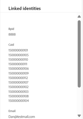

I believe I have and I can see the linked identities on the profile.  Each schema has the associated ID's defined as identities with the corresponding identity namespaces.  What else should I be checking to confirm this is configured correctly?
@DanSpigs1 Your screenshot confirms that all of these different account id's are rolling up to 1 profile (customer id: 8888), considering Bpid is one of the namespace used as an identity. Ideally, if there is a defined relationship between the customer and the account information schema, it should link all different account types (personal, business, savings) back to customer ID 8888.

With account info as you've laid out.  Screenshot above shows the associated Identities on the profile.
