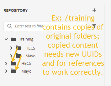

Hey folks! My team has this use case: As a content manager, I want to create a copy of a folder containing thousands of Guides items so I can use samples of "real" content for things like training, testing, etc. without giving access to the "real" content itself.

Or, is there a better way to duplicate large amounts of Guides content like this? Ex: Some way to package the content we want, manipulate the package to give duplicated content new titles/GUIDs, then reupload? Or are there other thoughts?
