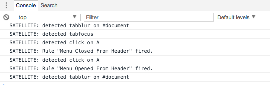

Here is console output from Observpoint plugin:

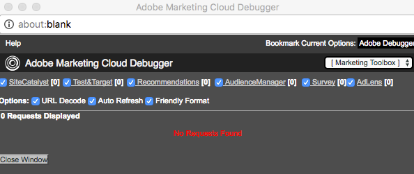

I confess that I find the Adobe Debug plugin a bit confusing and I've not been able to get it to generate any useful output.  You are talking about this interface?
If so, any clues on how to get interesting data from it?
