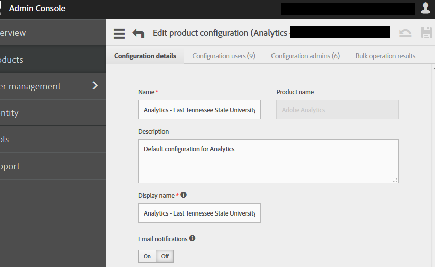

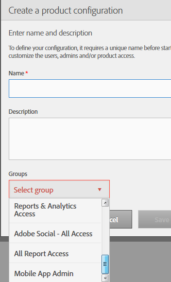

1) when i drop down the "groups" dropbox on a new project configuration, I do not see the group (mcom_students) that I created
2) i do not see any options or tabs to set permissions on project configuration as outlined in this help document Enterprise Help | Manage product permissions and roles in the Admin Console

You would need to create the product configuration and then add the group as a user of the configuration. The "Groups" label on your second screenshot is a bit deceiving. That is pulling a list of the permissions groups that you've set up within the product/solution (Analytics in your case).
If you haven't already seen it, I'd suggest watching the video I put out a few months ago on mapping a product configuration group. It might make things a bit more clear.
How To: Map a Product Configuration Group - YouTube
Let me know if you have any additional questions.
