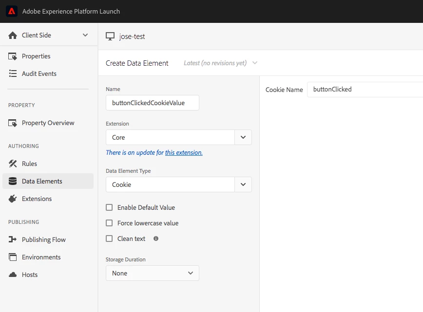

1. In Launch - Create a data element for the cookie where the value will be in.

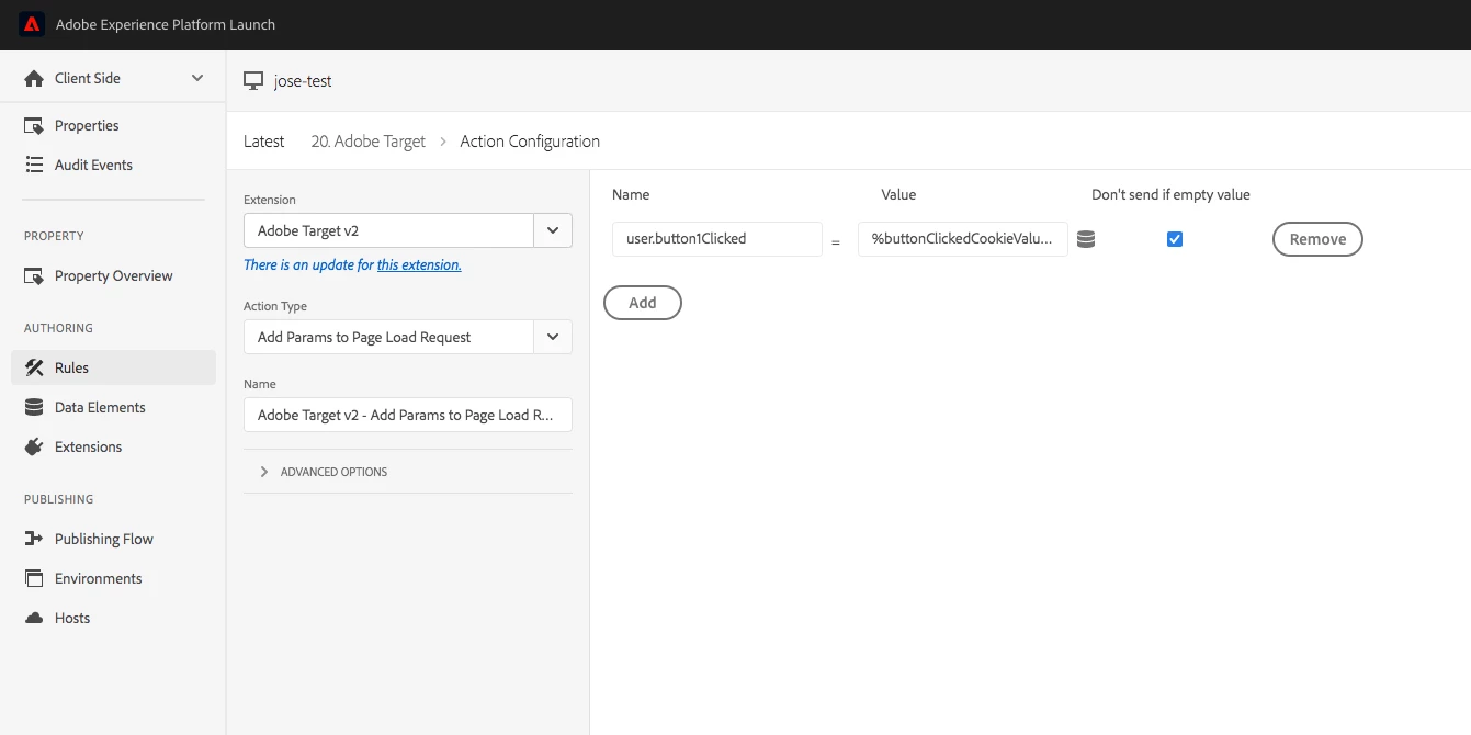

2. In Launch - In the rule for Target, we should add the parameter and the data element name. Please take note of what you enter as the value as you will need this in Target.

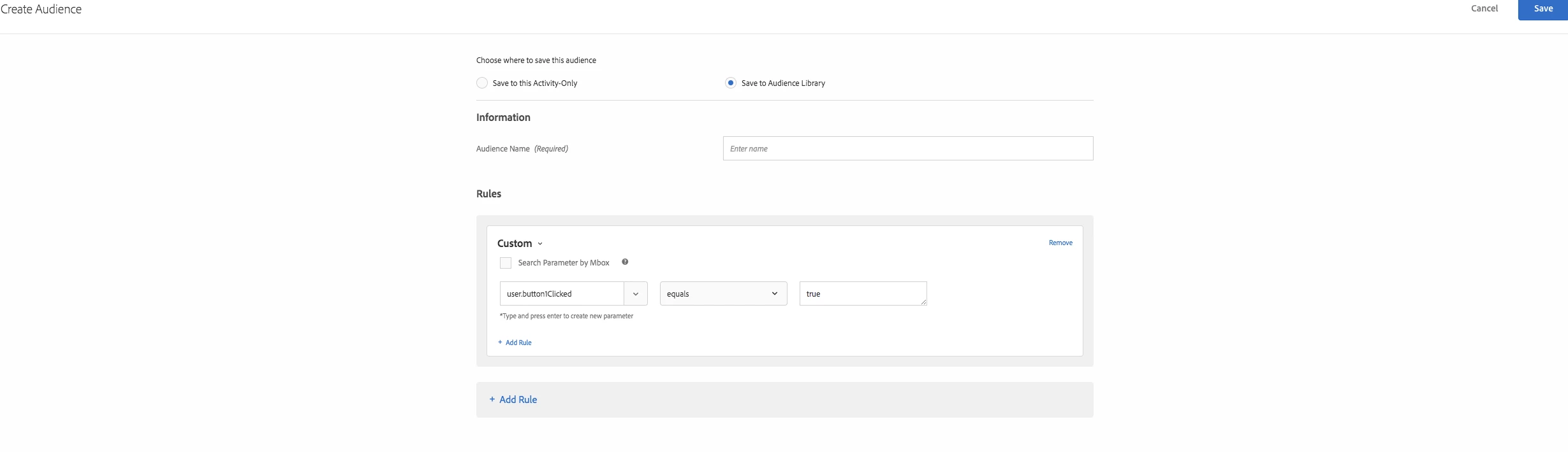

3. In Target, create an activity using a custom audience that uses the "Custom" option drop down when creating the audience, you should enter for the name the same value that Launch is going to send to Target as a parameter. Then you set it to equal whatever you need it to equal.

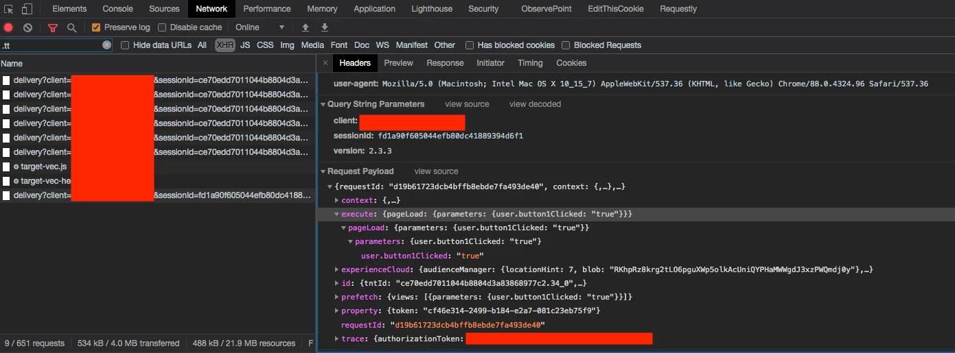

4. To validate, you should be expecting the cookie to be set when you click the button, on the page where you want to see the activity you should see in the parameters to target the value being passed in and the activity being displayed.
