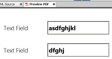

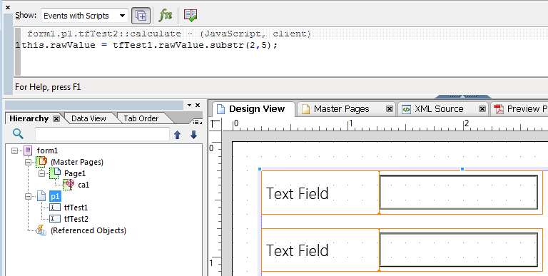

Level 7
Here's the method working using JavaScript.
Maybe the problem is with how the method works. The first parameter is the starting location of the substring, and the second is the number of characters to take. So, from your example, you start with character 2 and take 12 characters. If you only want to ignore the first character, try substr(1,12). That starts at the first character in the string. (Keep in mind that characters in the string are numbered starting from 0.)

Does substr have to be used in the calculate event? I have all my script in the exit event.
Level 7
No, that's just where I put mine for that example.
