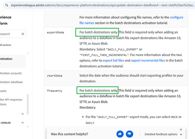

Not possible to use after segment evaluation export option if you are using the flow service API.
After segment evaluation is whenever the new audiences qualified to make sure the audience is updating to latest data.
while you pass to S3 bucket or any cloud where native connection is not there, it batch only now.
Screen shot:
Refer this - https://experienceleague.adobe.com/en/docs/experience-platform/destinations/api/update-destination-d...
