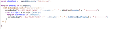

And so far the only way I've been able to reference any property in that object stack is to basically loop thru all the values at the index level and then all the objects in those index, like this:
Now I could do this, add logic to find my prop (if its there) and then capture the value, but this seems like overly complicated and I'm sure there is a better way. And while the rule set this custom script is in has to fire on the complete "window Loaded"( in case the dL values are added after the page load starts), this likely also is not going to recognize dL changes on new pushes.
