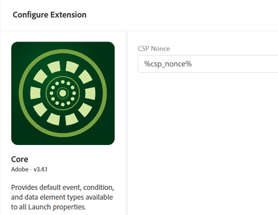

I would like Adobe Launch to add a nonce to all inline script it injects, so I created a Data Element which references the nonce value and configured the Core - extension accordingly.
Now there's a nonce attribute added to the <script>-tag but it is empty.
When I do _satellite.getVar("csp_nonce"); in the console it returns the correct value:
"csp_nonce" is the name of the Data Element I created and referenced in the core extension like this:

That definitely works! Thanks. Also  your first suggestion works in the meantime as I found out, the reason was that I have overseen an second CSP within the HTTP Response Header (containing only of frame-ancestors directive). As soon as I remove one of the CSPs (either the one defined in meta-Tags or the one from HTTP Header, it works. Having both of them will lead to the described symptoms. Hope that helps someone in the future.
