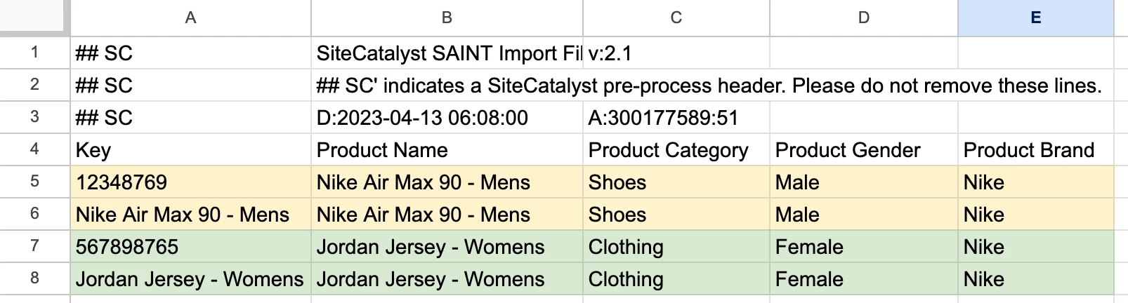

Since you will be doing SAINT (classification) uploads anyway, here's the trick that will make your analysis of pre/post data much easier.  In addition to uploading classification rows with the new product keys (SKU's), also upload rows with the old product keys (product names).  It will look a bit like this:
By doing this, you will be able to use the "Product Name" classification to report across the old data and the new data in a single report.
Note also that I added a few other classifications in the example above (Product Category, Product Gender, and Product Brand).  If you will be pulling info from your Product Information Management system anyway, you might as well get more than just Product Name.  Spend a bit of time exploring this topic - it can turbo-charge your reporting.

Yes, I've done this quite a few times for clients.  Using a product number (whether it is the SKU or some other unique product identifier) is always the best way to go.
