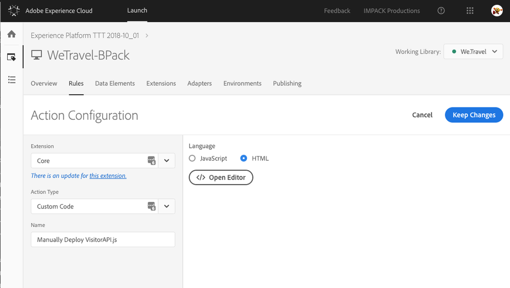

Thanks for the additional info.  Version 1.7.0 of VisitorAPI.js is really old and no longer supported since we are at version 3.3.0 as of today.  I would recommend upgrading to a newer library and ideally use the built in Launch Extension for "Experience Cloud ID Service."  Then you can just use Launch to keep it up to date goting forward.  However if your use case does not allow for that, you should still be able to create a "Custom Code" action in a Launch rule.  Just choose "HTML" as your lanuage and then click on "Open Editor" and just include the script tags you need.
In your example above, the test variable would just be a String however and not actually load the external library unless you append it to the DOM or do something with it.  But if that's what you want to have happen, then just escape the closing slash and Launch should not have any syntax errors.  This worked for me:
