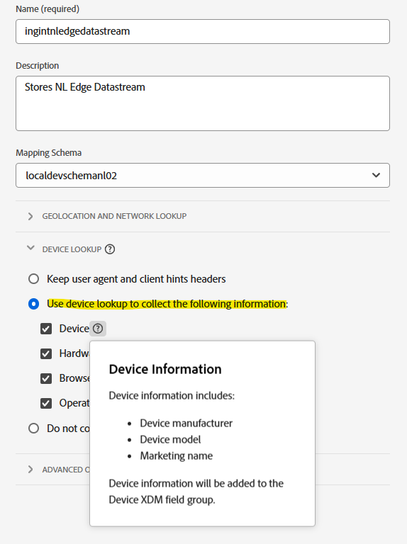

How to collect mobile information in my datastream
In my datastream, I selected the option to get mobile information collected:

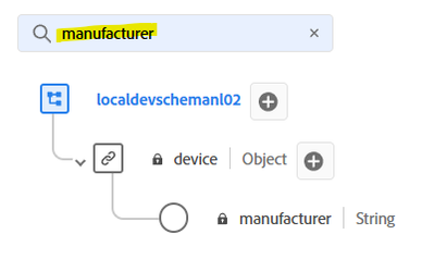

The fields are present in my schema but are empty in my dataset:
Do I have to add something in the mapping (nothing is mapped) or it will be done automatically?
