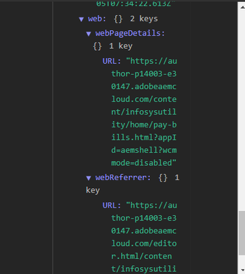

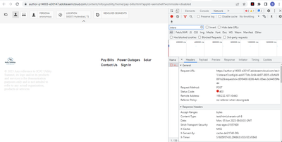

Now as per the document,they have configured data on the domain enablementadobe.com because of which they are using data.enablementadobe.com as the CNAME . I tried using data.adobeaemcloud.com but i got "405" as the response in the header.Then I tried author-p14003-e30147.adobeaemcloud.com  but then I got "403" as the response. I'm unable to get the web.webpagedetails.pageViews results due to this.Can somebody help me on giving the CNAME while setting up the Web SDK extension.
If you do not want to set up a CNAME you can use the default value of edge.adobedc.net

Hello @Sushmita32 - The Edge Domain is the domain that the Adobe Experience Platform extension sends and receives data from. Adobe recommends using a 1st-party domain (CNAME) for this extension. The default 3rd-party domain works for development environments but is not suitable for production environments.
I think you need to setup the first party CNAME. Here are the instructions on how to set up a first-party CNAME here.
