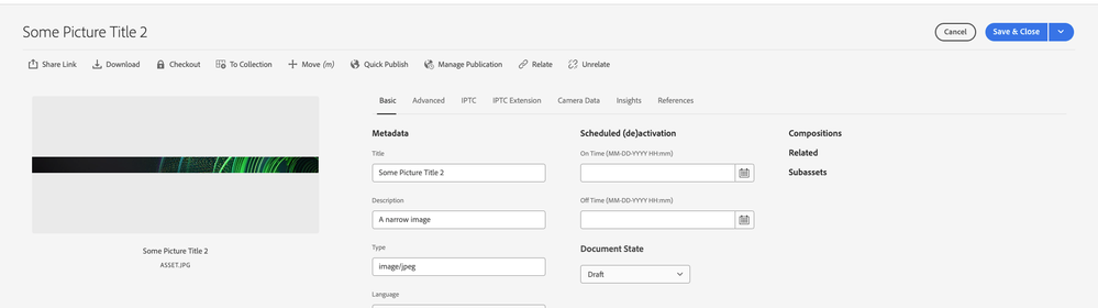

I am having same issue.
Using the api with this payload
    "class": "asset",
    "properties": {
        "metadata": {
            "dc:description": "this is added from API"
only updates the "jcr:description" field but not the "dc:description" field, and so the updates do not show up in the UI.
