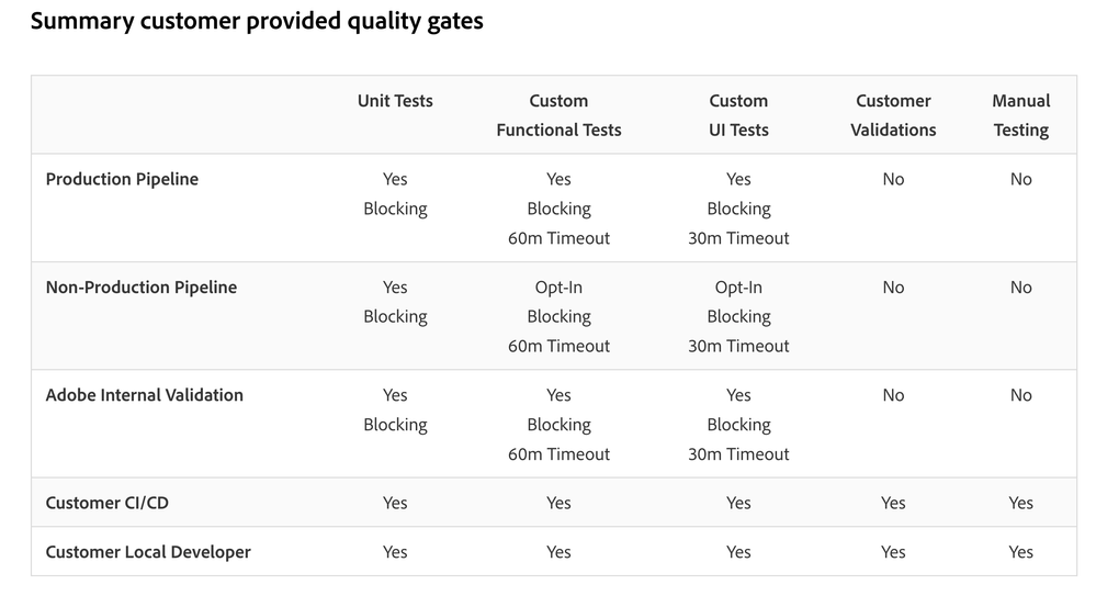

giuseppebaglio
October 16, 2025
Cypress test execution must be integrated into the pipeline lifecycle. This is evident in the profiles section of the pom.xml file in the AEM Test Samples repository, where it is triggered by a specific Maven profile. However, there are limitations you should be aware of while developing these tests, as outlined here:
