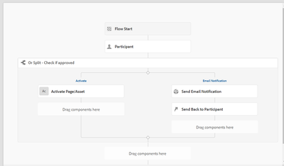

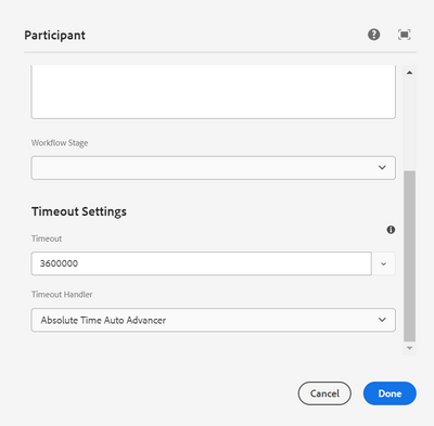

IMO, instead of writing the scheduler to find the list of the users who have not taken the action on the activity assigned on them, it would be nice to handle it via the main workflow itself using the timeout handler.
This way via the timeout handler you get the exact duration of the time period the job was lying with the participant user.
Sample model
Timeout Settings
Hope this helps!
Through my testing this does not work. I have a timeout set on the participant step like you have suggested and an OR split to handle the advance. However when it advances and goes back to the participant, the timeout is instant which creates an infinite loop of the workflow advancing and then sending back to the participant. Do I have to somehow reset the timeout as well?

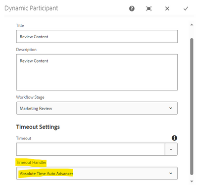

This worked for me. To make this answer more clear, I will provide the code and settings related.
1. I have a custom class that extends WorkflowProcess:
public class CustomProcess implements WorkflowProcess {
 2 and 3. I have these lines of code in that class to assign the "absoluteTime" variable:
Date date = new Date();
long millisecondTimeInSevenDays = date.getTime() + (60000 * 60 * 24 * 7); //millisecond value of 7 days. Customize to how long you wait to send a reminder
workItem.getWorkflowData().getMetaDataMap().put("absoluteTime", millisecondTimeInSevenDays);
4. In the workflow model editor, I have a step that assigns a timeout handler to "Absolute Time Auto Advancer"
In addition, you will need to do what @ShaileshBassi did with the Or Split to handle the email notification.
