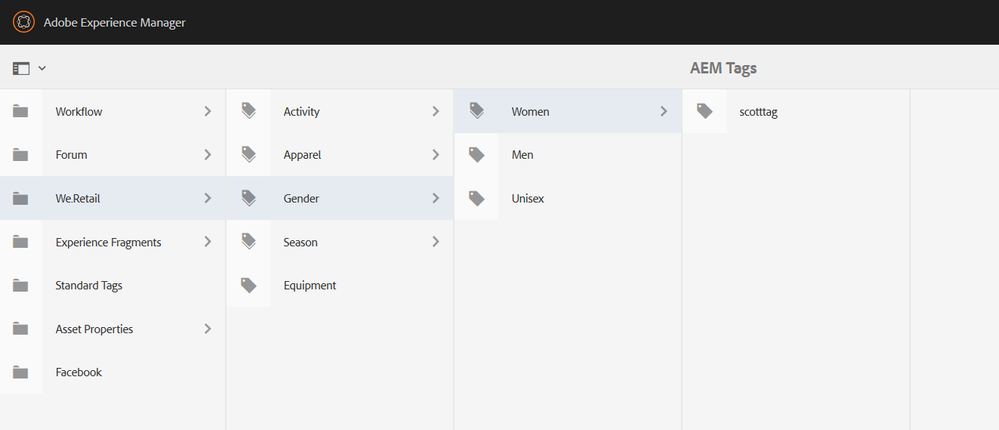

When you create a tag in AEM 6.4 - you see the path in which the tag is stored.
Here you see the proper path:
If you are not seeing tags stored in the path - that is specified in Tag Path when you create the tag, there is an issue with your AEM instance. As this is not a fresh AEM 6.4 instance - but rather an upgraded server - i am wondering if there is an upgrade bug responsible for this behavior.
