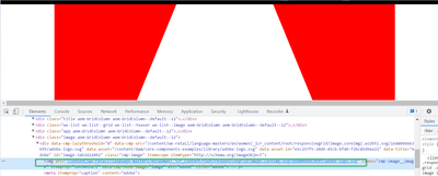

Below you could see I have added svg image using we.retail image component and it's getting displayed perfectly -
Even I have dropped the .svg image in parsys and it's working also.
Please check the log file what is the error you are getting. I am using AEM 6.5.9
