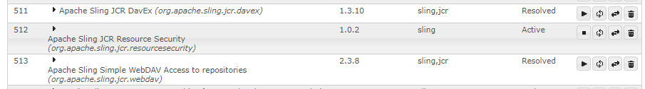

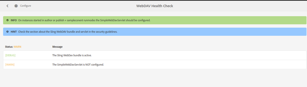

Hey @ArpitVarshney,
Thanks for the reply!  Here are some screen shots of the bundles in question and the Security Checks -> WebDAV Health Check.  The bundles are not active as suggested per the Security Checklist.  However the WebDAV Health Check is giving me a warning [WARN].  If the bundles should not be active, then the WebDAV Health Check probably should not be in status:WARN, but instead should be in status:OK.  Maybe I am missing something?
clint
