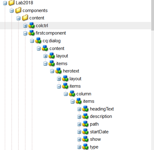

To test this - install the package in the third section of the article above. The section is titled -- Add additional resource types to your component
This will give you this structure under /apps.

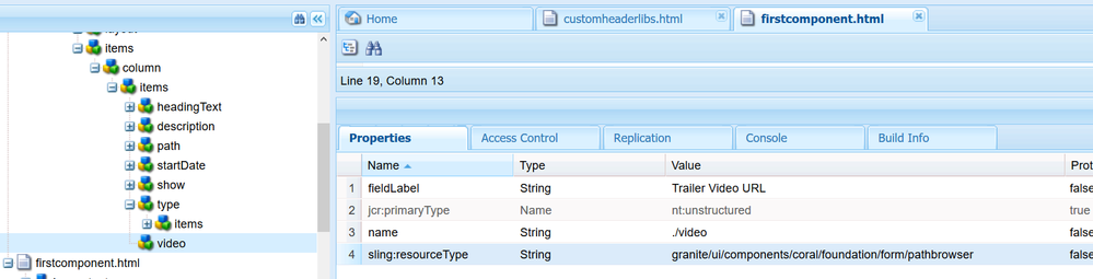

Add a new node under items named video with the following Props:

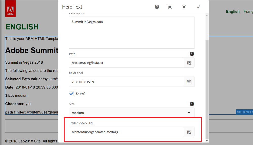

Now open the dialog and you will see the pathfinder:
This value now prints out on the page --

I am still seeing it work well when i change the resource type to this:
granite/ui/components/coral/foundation/form/pathfield
The result...
Try the steps that i listed above on a fresh install. use that package and add a new node with the resource type -- granite/ui/components/coral/foundation/form/pathfield.
