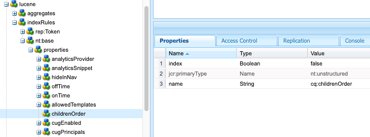

However, when I check on indexes created in We Retail project, I can see that there are nodes like this:
/oak:index/lucene/indexRules/nt:base/properties/childrenOrder
There is lucene index with many properties inside indexRules node. Every property has attribute index (Boolean) = false. Per Lucene documentation, this means that this property (in this practuculat case childrenOrder) is not indexed.
What is the reason behind this? When we don't want these properties to be indexed, why are they inside the index? If I got this right, there is no sense to put property inside indexRules (to be indexed?), and than put its index value to false (to exclude it from indexing)?

Does that mean that without these properties defined, these indexes would be indexed?
if the structure is like this:
- lucene
- aggregates (nt:file)
- indexRules
- nt:base
- properties (nothing inside)
Would then everything that is (or extends) nt:file be indexed (every single property)?
I am not sure if some property is indexed without being defined inside indexRules/properties, or it is OOTB behaviour and then if we want custom behaviour for some properties, we define them inside indexRules only then?
I believe you will have to specify each property that you want to index. If you won't define a property inside indexRules/properties, it won't be indexed.
