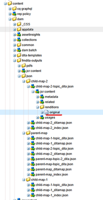

For instance, consider the folder /content/dam/fmdita-outputs, which contains subfolders such as child-map-1, parent-map, etc. Each of these subfolders includes JSON files. When we trigger Sling Distribution using our custom agent, we want it to export only the actual JSON files — maintaining the same folder structure — and save them directly in our local file system.
Currently, the default behavior creates a Vault package containing all node data, rather than exporting the original JSON files. Hence, we are exploring the possibility of implementing a custom Package Builder that can handle this logic and directly save or send the JSON files as-is.
I have attached the relevant code snippets from our setup along with the current output generated when using the FileVault Package Builder for reference.
Node structure:
The /content/dam/fmdita-outputs node represents the DAM folder that contains the generated output files. Each subfolder (e.g., child-map-1, parent-map, etc.) holds one or more JSON files — these are the actual output files that we want to replicate or export in their original format (not as part of a Vault package).
