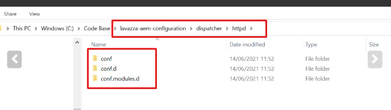

This is how my project dispatcher folder structure looks like:
Thanks in advance for your guidance!
